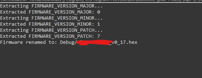

if everything works correctly, when you compile your code you will obtain the following result:
(in my case I used the script on the debug configuration. if you need, change it to release or something else configuration).

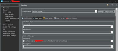

The post-build command goes into the project settings:
As you see, CubeIDE variables can be used in the commands, with ${...} syntax.

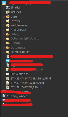

This is based on git "bash.exe" command. The follow instructions show you how I obtaine my scope in only few steps. For first I create a sh script calles "FW_version.sh", and I placed on the project root:
the content of "FW_version.sh" is the follow:.

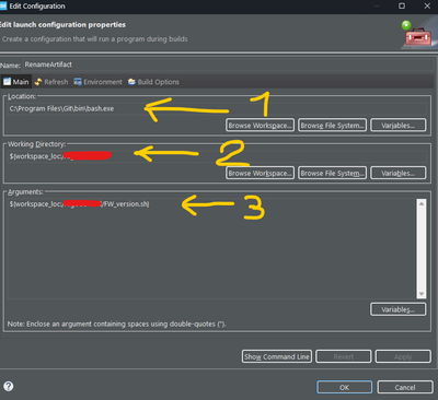

Second step is to create a new builder and inserting it into the project:
So, right click on the project, properties --> Builders --> New.
Compile the step 1,2 ,3 with your preference:
"1" is the "bash.exe" program present on GIT folders
"2" is your project folder
"3" is the script locations (I.E. = ${workspace_loc:/TestProject/FW_version.sh}  )  [pay attention to the syntax]
Last step is compile your post-build command with : ${workspace_loc:/TestProject/.externalToolBuilders/RenameArtifact} [pay attention to the syntax]
