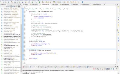

I dont know why this error happens. It is aligned as 0x0800F800.
Not only this, but i get a hardfault (UNDEFINSTR) error too, while printing the above error with the following:
printf("Error writeFLASHDoubleWord FLASH->SR: %02X", READ_REG(FLASH->SR));
You are spot on. I did not think about how big a page actually is ;-).
I put it now at the end to not get a problem again. But i found out, that after erasing pages, my writing does not work anymore. If i comment out the erase, i can write the flash. How can the erase prevent me from writin?

You can read FLASH->SR directly, and its not at 0x800F800
Your error is coming from something else. Decompose the Hard Fault, presenting those registers and the machine instructions that are faulting, so it might be more apparent what the actual issue is.
The printf() doesn't look intrinsically wrong. Are you perhaps deleting the code/data that relate to the instruction, the library, the string?
A double word would need to be on an 8-byte boundary, and the content properly erased.
Going to need better presentation and context to understand why this is failing.

>>How can the erase prevent me from writing?
It didn't complete yet?
There's some pending error?
Hard to tell anything from screen shot code fragment. Need to see output and sequences from an instrumented process. Best not to single-step in debugger, or dwell on the peripheral view. Print out info about the stages, and the register in hex at each point. Decimal not helpful.
I dont do single step as i know of the problems.
But i found my problem: i did not clear PER and PNB after erase, which gave me troubles. After findind out you can write some flash without erase, i went like this. But it seems that it does not work any kind of predictable.
