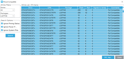

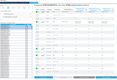

Hello @E-John
Yes, it should be easy to do this migration.
You have to take care of some differences in hardware, peripheral availability, firmware, security, and tools.
Also, you can use both Cross Selector:
and Pinout compatibility feature:
available using STM32CubeMX.

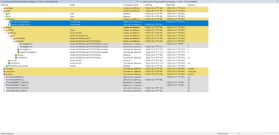

E-John
@STTwo-32
---> Here are what I have found.
1. make projects 01-STM32G0B0RE and 01-STM32G0B1RE by STM32CubeIDE tool
    Make code generated by tool.
2. Make a comparison between two projects directories like below
3. Different files are startup, CMSIS and linker scripts, see table below
 STM32G0B0RESTM32G0B1RE
startup file
01-STM32G0B0RE\Core\Startup\
startup_stm32g0b0retx.s
01-STM32G0B1RE\Core\Startup\
startup_stm32g0b1retx.s
CMSIS
01-STM32G0B0RE\Drivers\CMSIS\Device\ST\STM32G0xx\Include\
stm32g0b0xx.h
01-STM32G0B1RE\Drivers\CMSIS\Device\ST\STM32G0xx\Include\
stm32g0b1xx.h
linker script for flash
01-STM32G0B0RE\
STM32G0B0RETX_FLASH.ld
01-STM32G0B1RE\
STM32G0B1RETX_FLASH.ld
linker script for ram
01-STM32G0B0RE\
STM32G0B0RETX_RAM.ld
01-STM32G0B1RE\
STM32G0B1RETX_RAM.ld
4. HAL level drivers seems to be the same.

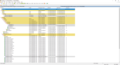

We have an project with the STM32G0B0 and bought the STM32G070 Nucleo and solderd the G0B0 to is, it is 1 to 1 pin compatible ony has USB and the 070 doesnt have USB
@PieterInHetBos
make projects 01-STM32G0B0RE and 01-STM32G070RB by STM32CubeIDE tool.
Compare these two directories, the startup file, header files under CMSIS\Device\ST\STM32G0xx\Include\ and linker scripts are still different.
The best way I can think is to create two projects for different platforms, and merge the hardware independent code from 070 to 0B0.
