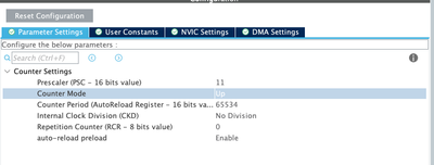

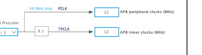

You don't show any of the TIM initialization code.. check prescaler, check clocking via MCO pin.

 htim16.Instance = TIM16;
  htim16.Init.Prescaler = 11;
  htim16.Init.CounterMode = TIM_COUNTERMODE_UP;
  htim16.Init.Period = 65534;
  htim16.Init.ClockDivision = TIM_CLOCKDIVISION_DIV1;
  htim16.Init.RepetitionCounter = 0;
  htim16.Init.AutoReloadPreload = TIM_AUTORELOAD_PRELOAD_ENABLE;
And I don't use interrupt for this timer.
Implementing delta for CNT didn't help.

7us on a 12 MHz chip is 84 ticks. That's not a lot. You're jumping/returning to a function, dereferencing pointers, accessing registers. Likely compiling under Release mode would do much better. Using direct register access will help a bit.
Yeah, I think the same but hope that I'm wrong. :)
Strange but even on 48MHz and release build I got 102uS instead 100us.
96 ticks of overhead is consistent with what you saw at 12 MHz clock.
I would guess about half of the overhead is within HAL_GPIO_TogglePin itself.
