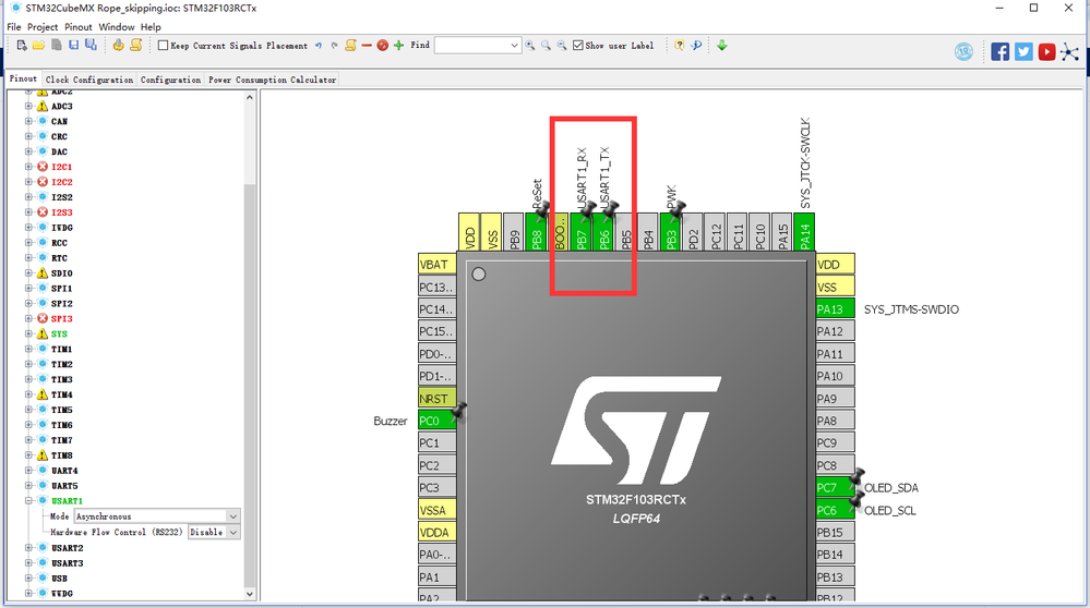

In my project, I need to use PB6, PB7 as the pins of USART1.
But,when I set it,I can't  connect to ST-Link,

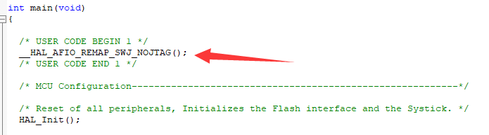

I'm sorry, I accidentally sent the problem out, when I was not finished.
Someone told me to disable JTAG, I did it, but ST-Link still did not work.
But JLink is still working in JTAG mode.
I don't konw why~
Do I need other code to disable JTAG?
