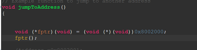

 in my project I am try to jump 0x8002000 address . but I am facing some failure,
typedef void (*FunctionPointer)(void);
// Example function to jump to another address
void jumpToAddress(uint32_t * address) {
//address =0x800029c;
    // Define a function pointer with the address
    FunctionPointer jumpFunction = (FunctionPointer)address;
    //void (*jumpFunction)(void) = (void (*)(void))address;
    // Disable interrupts if needed
       __disable_irq();
       // Set the program counter (PC) to the new address
       SCB->VTOR = address;
       // Execute an instruction to ensure that the jump takes effect
       __DSB();
       __ISB();
       // Re-enable interrupts if needed
       __enable_irq();
    // Call the function via the function pointer
    jumpFunction();
this is my address jump function .

Vector tables need to be on 512-byte boundaries.
They are tables of addresses, not code.
Thr function pointer needs to be odd, per how the CMx processor indicates 16-bit Thumb code.
Have a working/reporting HardFault_Handler so you know it got there.
Learn to use the debugger so you can step the code and understand behaviour and failure.

thanks for your response.
I am a beginner for ARM  Based controller. So kindly  explain for this address jumping process or kindly give sample code for this process or kindly share document for this process.

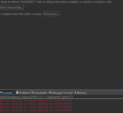

hi,
I am try below  mentioned method in way Hardfaulthandler error is happend.
kindly help to me. I am struggling  past 4 days .
