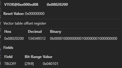

143 - 15 = 128. So it's off by 128, I'm sure that's not a coincidence.
I would say that's an issue with SCB->VTOR not being set to a multiple of the vector table length.
If my interpretation of your screenshot is correct, you have SCB->VTOR = 0x08020200. Perhaps this isn't valid and it needs to be a multiple of 0x400. I'm not going to dig into documentation but that seems probable given the symptoms. Try 0x08020000 or 0x08020400.

Put a breakpoint on this line and, when it gets hit, show the value of the SCB->ICSR register in a screenshot, along with SCB->VTOR and the relevant entries in there for the 15th and 143rd interrupt addresses.

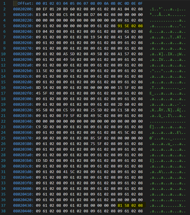

tl12
The active exeption at this breakpoint is the ADC3 interrupt and the VTOR value seems to align with the observed vector table offset:
The vector table entries for SysTick_Handler and ADC3_IRQHandler are highlighted.
tl12
0x08020400 worked, thanks! :)
