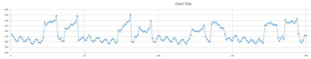

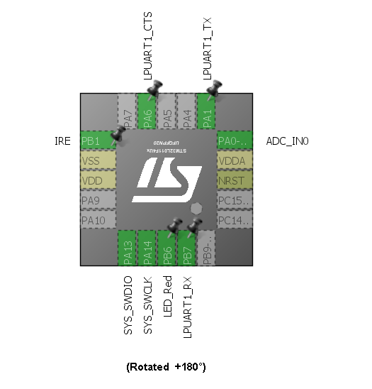

I am very new to STM coding and starting with the basics. I am using a STM32L011 uC and IAR compiler.
I am trying to measure voltage from a sensor that is dumping analog data at about 5Khz. The ADC values then need to be transferred to via UART to my laptop for post processing.
The problem is that even though the STM32L011 is sampling with internal clock of 16Mhz and UART is dumping data at 56000 Baud Rate (WHTHOUT hardware flow control). The resulting graph of the ADC plot on my laptop has awful resolution.
I dont understand where the problem is . Is it the transmission bottle neck which i doubt because the
resulting graph of the ADC plot on my laptop is more or less the same even if i change the baudrate. Since i am using a simple while loop to pool for conversion for the ADC data and then transmitting to the system, the ADC conversion speed should be limited with the uart transmission rate and change with increasing or decreasing baud rate but this doesnt seem to happen.
Given below is the expected (oscilloscope) and actual plotted graphs (excel graphs which are no where close to expectations)
Any help in how to get the ADC values on the Laptop in as much real time as possible is appreciated.
How many bytes per sample ?
Assuming 10 bits per byte (including start and stop bits), you have quite a problem here with single-byte data, and assured malfunction with 2 bytes per sample.
You will need a better strategy, the transmission needs to run quasi-parallel with sampling and preparation for send.

Thanks for the reply AvaTar, So what strategy do u recommend? this STM32 can go upto 4MBps but  that also doesnt help. Receiving at 2MBps baud rate gives a better graph (given below) but still no where near to what i expect.
