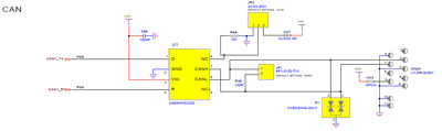

MCP2515 is not a transceiver but it's a CAN controller using SPI interface.  You need to add a transceiver to use this kind of controller.
Are you sure this is the right part number? if yes, why are you using an external CAN controller while STM32F446 already embeds two CAN instances?
I can recommand either SN65HVD230 or MCP2562 as CAN 2.0 transceivers.
Example of schematics from STM32446E-EVAL board:
Start using loopback mode for first CAN tests. You can inspire from this example: https://github.com/STMicroelectronics/STM32CubeF4/tree/master/Projects/STM32446E_EVAL/Examples/CAN/CAN_Loopback
