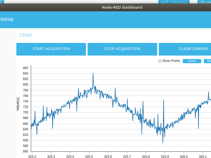

Hi all!
I'm developing on a evaluation board NUCLEO-F446RE STM32 F4.
I've to read an adc input in order to monitor a battery.
There's a lot of unexpected noise in my acquired data, as visibile in attahments.

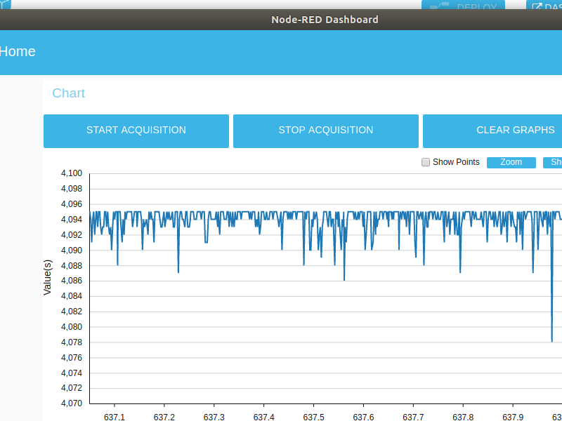

I've tied directly the adc input to Vref and to a function generator, this noise in always well
present, as visibile in the attachment below.
I've been tryng to tie vref to a very clean reference, but nothing changed.
Can somenone tell me how to indepth my investigation?
Below my adc settings:

waclawek.jan
ADC in what's primarily a massive digital circuit is always inherently noisy and 10 bins of noise is nothing extraordinarily excessive. To get below that requires quite an amount of work - very careful analog supply and ground(!) routing/decoupling/separation from digital supply/ground, careful choice of ADC clock, sampling time, careful conditioning of the input signal, stopping the digital part while taking ADC readings, digital post-processing/filtering, etc. - and the result still may seem underwhelming. That's just reality.
Read AN4073.
