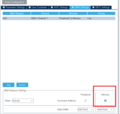

Hello @Pejwaak,
Please, make sure in your DMA settings you have correctly enable the incrementing address of "Destination Address".
Feel free to share your settings :)

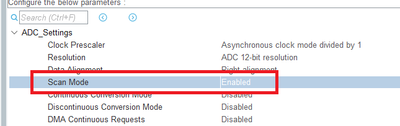

Did you enable Scan mode?
Did you enable Memory incrementation in DMA config as stated by @GwenoleB ?
Hi
Yes, I have taken every standard step according to the examples. Like I said all channels are being sampled but at the end of the sequence only one channel is written to ACDArray[0] and the rest remain zero. then at then end of next sequence the values for another channel is written two ACDArray[0] and the rest remain zero. It is really odd.
