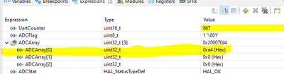

I am facing an odd problem with ADC in conjunction with DMA on STM32L151V8T-A.
I can see that it measures all three channels. However, the result of each channel is stored in the first element of my results array (Result[3]).
Every time that the callback function is called the results of one out of three channels is stored in Result[0] element. It is as if the memory address is not increasing.
Can somebody help?

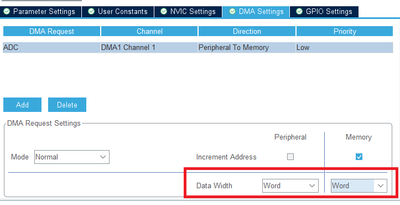

Hello @Pejwaak ,
Change Data width of Peripheral and Memory to "Word" instead of "Half Word":
Please confirm if this solves your issue.

I have already tried it but tried it again any. I am attaching this screen-shot so you know exactly what I mean. Every-time ADC complete flag was set I took a screen shot. as you can see the value of the first element of ADCArray changes. I tested them and it turned out that these differents values are the values from each three channel.ADC3.PNGADC1.PNGADC0.PNG
