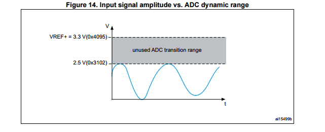

I work with the stm32l073rz. I  measure the sensor with the ADC and the retrieved value is correct.
Now, I want to increase the precision. The sensor gives a little value (maximum 1.5V). Can I reduce the intern ADC voltage to increase the precision like this figure ?
Thank you very much for your help
Regards
Simon

Assuming calibration is done, using oversampling (if possible) would be the first step to less noise.
The VDDA should be a clean non noisy source (PSSR power rejection impacting the precision and performance).
In theory, reducing VDDA might help 'less than' a bit. Your main goal is to reduce the SNR.
If the signal is not random and is characterized, digital filtering post processing may also help.

Wouldn't adding a buffer amplifier (x 2.2 = 3.3V / 1.5V) do the same job ?
It would relax possible input impedance issues as well.
