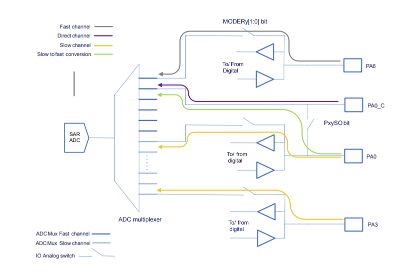

I'm having some throuble in reading the direct analog input on channel PA0_C.
In my design I'm using several analog input. They seems to work properly in general and I have a precision more or less as expected. On channel PA0_C, though, I'm having a noise that is defenetly higher then the other channels (around 8-10x).
And I can't find the origin of this issue. I've get rid of the analog signal shorting the analog input to ground whit a 0 ohm resistor. The noise is still there and more or less the same (around 400points of adc, with a Vref=2.5V).
Going deeper with my investigation I've disconnecte the pin of the channel PA0 thet is not a direct channel, and closed the bypass switch that short PA0 and PA0_C. In this way I'm sure that the analog signal insede the chip is the same for both channels.
0693W00000YAmL9QAL.pngEven in this scenario the PA0_C channel gives worst results.
Does anyone experienced something like that?

Hello @MNico.2​
Here are some suggestions that might help:
  1. Check for any noise sources that may be contributing to the issue, such as power supply noise (try using a different voltage reference or a different power supply), ground loops, or EMI.
  2. Try to swap ADC fast channels to see if that makes a difference.
  3. You can also try using a different voltage reference or a different power supply.
