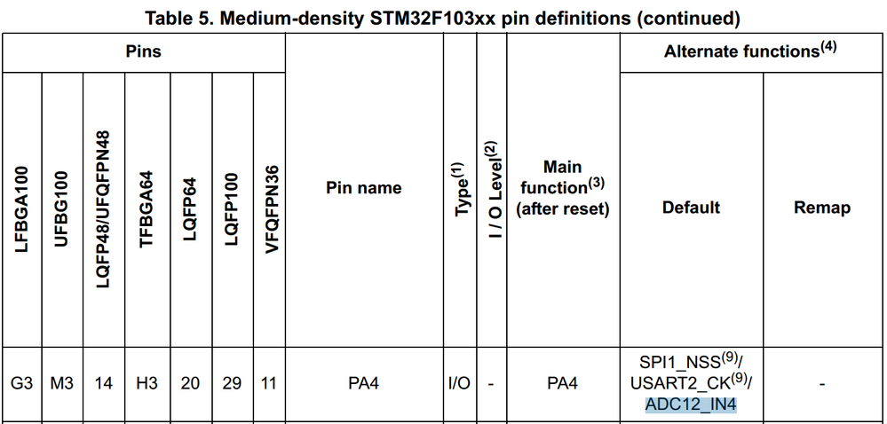

I would like to infrom you that I am trying to measure battery voltage which is connected to ADC12_IN4 pin of stm32f103c8t6 microcontroller with ADC.

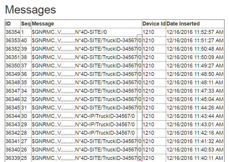

I wrote proper code for configurations and reading battery voltage.But Unfortunately it only shows ''0'' as battery voltage in integer.I obtain this data and analyze using web server, in this case I am able to see what is the value of battery voltage.

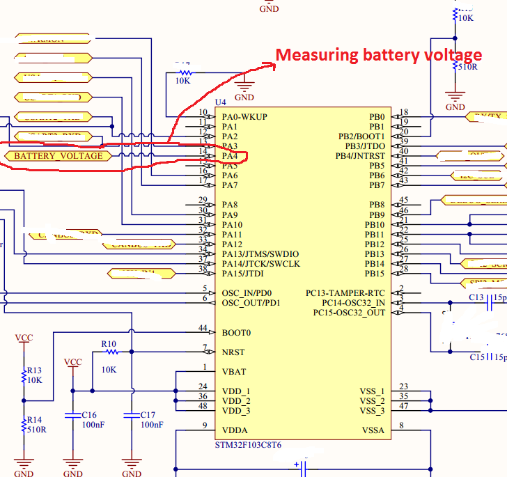

I would like to show you my circuit design,datasheet and part of code for clear understanding
Datasheet, pin connection
Part of my circuit design with microcontroller

Here what I see in my server (ALL ZERO ''0'')

Your code doesn't have any sensible flow or logic to it. You don't enable the interrupt on the ADC, nor do you create the conditions for the EOC interrupt to occur.
I'm assuming here the IRQ handler never gets called, something you could perhaps confirm with some debugging. Consequently the variable never changes from zero.
When you get an EOC interrupt the data is already available, you read it and start the *next* conversion. More sensibly you use a TIM to pace the conversions are some reasonable frequency, a value you write at 1Hz doesn't need to sample thousands of times per second.
Move all the initialization stuff into one spot, put the channel selection and start conversion stuff .
