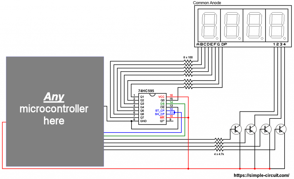

How would this differ from driving a 4-digit 7-segment display from any other microcontroller?
"I am using SPI between uC & 74HC595"
Show a schematic - how is it all wired together?
"My data is display properly but unable to handle display switching"
What, exactly, do you mean by that?
What have you tried? Where are you stuck?
Again, the concept is independent of what microcontroller you use - so there are plenty of examples to look at online ...
https://www.google.com/search?q=74hc595+7+segment+4+digit
From the first hit:
0693W000008xfE0QAI.png https://simple-circuit.com/arduino-7-segment-74hc595-shift-register/
I am using such 4 display modules connected in daisy chain.
i.e. clock, latch & digit enables pins for all four displays are connected together & data line is connected from one 74hc595 output to datain of 2nd 74hc595 and likewise....
Please post a schematic - trying to describe electronic systems in text is really ineffective. Especially in a non-native language.
