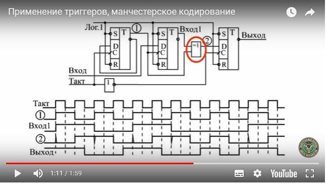

Thanks for your input, I think im going for the external microcontroller that just deals with the 1mbps manchester encode and decode. What is the best way to do this?
Encoding, with 2MHz spi output and convert the bits (0=01) or just with timer interrupts that toggle the output (500ns)?
Decoding, with edge timers?

Appetite grows, already 2mb.
Coding Manchester from spi is possible in the native version. This requires an external clock signal, spi in master mode. The output of the frequency you need can be performed in a dozen ways, the easiest - through the timer. The frequency should be 4 times higher than the symbol rate, intermediate reports are needed to encode the exact intervals. An element in the red circle is exclusive or, for example, CD74AC86M. Counters CD4013E, or analogue in the case you need. To bypass errors you will have to use the modeling environment, or the breadboard (much longer). When encoding to the Manchester, there are no stops when there is no data - zeros are transmitted.0690X000006044bQAA.jpg
Manchester decoding is much easier.
You have a timer, it needs three comparisons, or two comparisons and one overflow, an external start. On the remaining logic elements, we make the pulse generator of the timer start, we need an external comparison circuit for selecting the pulses, the dependence is the output of the comparison of the timer itself. Also, the timer comparison output is used as a clock for spi. On the remaining external trigger is a counter for 2, the output is used for spi input, control from the timer comparison output. The scheme of electrical inclusion of elements can be created in five versions, it all depends on the external hard logic used. The timer output beyond the overflow limit, or the maximum comparison - the trigger of the program synchronization start.
Synchronization is a separate headache.
This is the reason for using a separate ?, or even an FPGA. Before synchronization, you will have to process each received bit in manual mode - using matrices and state tables. After the synchronization, you need to hit the spi, then everything will be automatic.
The data transfer protocol must use the capabilities of the receive buffer spi: commands and data are of equal length, the packet must have a known number of parcels, synchronization and a checksum in each packet. Using your own protocol is not a good idea, you have already been pioneers, use their experience. So it makes sense to use CAN, in this case, synchronization is easier.
You can make a fully programmed Manchester, in the global network there are ready-made examples on C. It works absolutely on any processor, but takes up all of its time. For a small microscope, this can be a problem at a speed of 1mbit and higher, because it still needs to communicate with a large micron. Examples are searched through googol on open repositories and forums.
