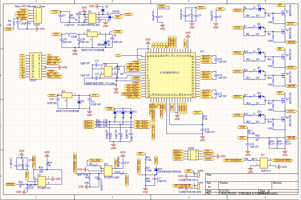

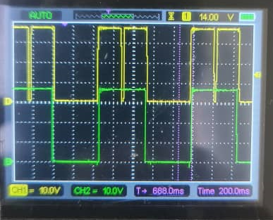

I use Schematic diagram of "EVSPIN32F0251S1" in my design with Hall Sensor and I use all its configuration for my board :
0693W00000GZUJCQA5.pngand I used a below BLDC motor :

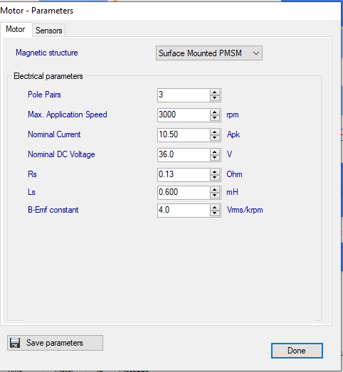

power:300W
current:10.5A
voltage :36V
speed:3000 RPM

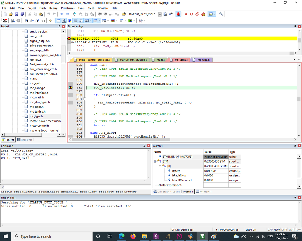

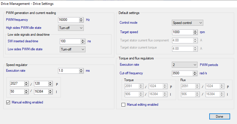

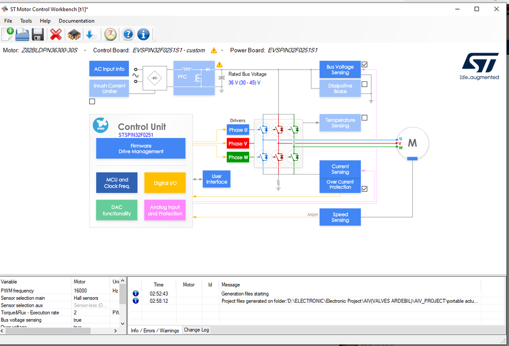

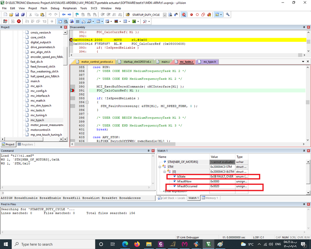

but I do not have any move in my motor
0693W00000GZUCkQAP.png0693W00000GZUKoQAP.pngand output phase U and V is:0693W00000GZURuQAP.pngI have no Ls and Rs and B_emf about my motor
