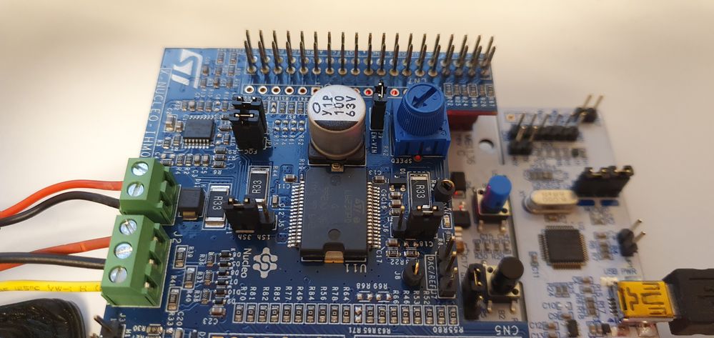

The 3-shunt pins are the ones on the left and right side of the MCU on the driver board.
They are both in 3-sh configutation
