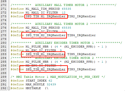

warning: #47-D: incompatible redefinition of macro "SPD_TIM_M1_IRQHandler"
llm
I had a mc sdk problem like as this question: https://community.st.com/s/question/0D53W00000S6AdLSAV/driver-motor-program-error-when-i-use-hall-sensor-and-encoder-at-the-same-time
My platform is: stm32f446re, MotorControl Workbench 5.4.7,mdk-arm v5,STM32 F4 FW V1.26.1.

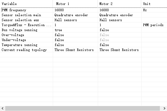

I used both the Hall sensor and the encoder, the encoder serves as the Main sensor and the Hall sensor as the Auxiliary sensor.
0693W00000GXOD9QAP.pngwhen I build the code, there is a warning: ../mx/Inc1/parameters_conversion.h(283): warning: #47-D: incompatible redefinition of macro "SPD_TIM_M1_IRQHandler" (declared at line 273).

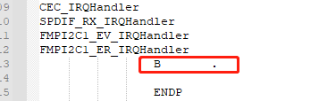

0693W00000GXOBJQA5.pngwhen I run and debug the code, it alway run to the default_handler.
0693W00000GXOEvQAP.pngwhen I disable the irq of the tim2 tim3 tim4 and tim5, this would disappear.
Could you fix this bugs?

Hello @llm​,
This configuration is not supported by the MCSDK.
In the next version of the MC Workbench we will prevent the user to select a sensor at main sensor and another sensor at auxiliary sensor.
The same question is already answered here :
https://community.st.com/s/question/0D53W00001BRIRoSAP/bug-report-mcsdk-5y3-generated-code-has-macro-redefinition-and-undefined-identifier-errors
Regards
Cedric

Hello @llm​ ,
MCSDK is able to drive a motor without any sensor, or with an encoder, or with hall sensors.
Could you describe your application and how do you want to use both sensors from application point of view ?
For your information, the primary target of the MCSDK is to demonstrate our board capacities. Up to know, all our power boards share the same pins for Hall sensors and encoder, this is the reason why we have an exclusive support. This is NOT a stm32 limitation.
