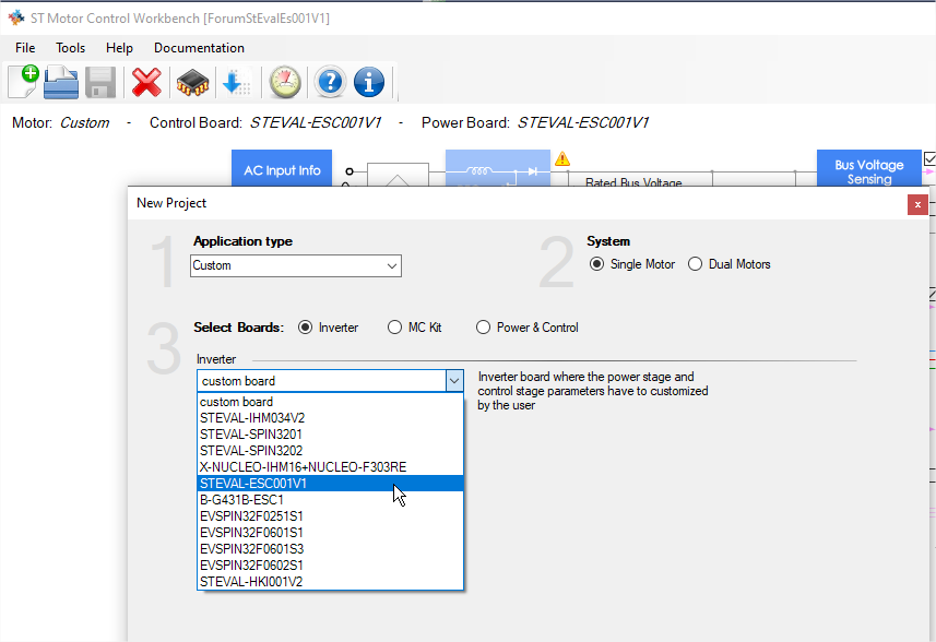

User manual UM2200 for STEVAL-ESC001V1 (purchased recently) tells me to install STSW-STM32100. I have searched st.com but cannot find it. The databrief tells me I shall have a motor running in minutes. So far it's 3 days. What do I do?

Could you try using Workbench MCSDK5.4.8 e.g.? You can generate your project as below:
0693W00000QLRuCQAX.pngBest regards.

Thank you for your answer. I ended up using Motor Control Workbench 5.Y.4 following an answer by KnarfB, to a related question. I think a key part of the puzzle for a newcomer is to realise that you have to select from inverter rather than Power & Control.

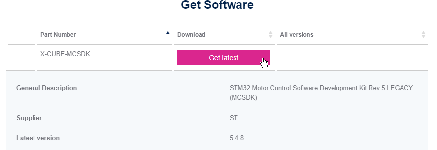

I tried to find it anyway but after many searches at st.com the best I can get is says
No results found for: workbench MCSDK5.4.8. Showing the results for: pworkbench.
Perhaps only employees have access to this software?
GMA
Please try:
https://www.st.com/en/embedded-software/x-cube-mcsdk.html#
