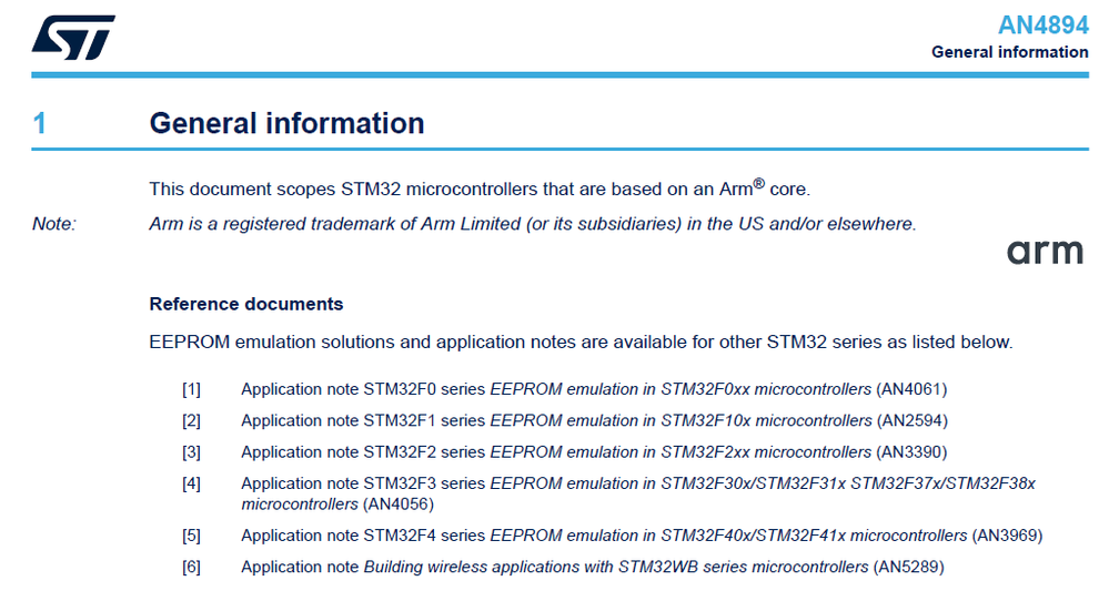

X-CUBE-EEPROM - not for STM32F0 ?
Andrew Neil
It's not mentioned in the Databrief or AN4894 or elsewhere
https://www.st.com/en/embedded-software/x-cube-eeprom.html
So it's AN4061 instead ?
STTwo-32
Hello @Andrew Neil
As you can see on the AN4894 or the Databrief, The X-CUBE-EEPROM doesn't support the STM32F0 series. So, the best guide will be the AN4061as you already said.
Best Regards.
STTwo-32

Does the  X-CUBE-EEPROM provide any enhancement over AN4061 features or performance ?
@STTwo-32 wrote:
Hello @Andrew Neil
Oh yes - so it does!
So X-CUBE-EEPROM also does not support:
  • STM32F1 - see AN2594 instead;
  • STM32F2 - see AN3390 instead;
  • STM32F3 - see AN4058 instead;
  • STM32F4 - see AN3969 instead;
  • STM32WB - see AN5289 instead.
