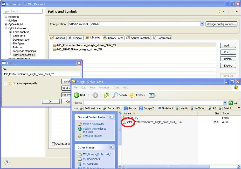

I think it's because the library (single dual drive.a) is not recognized by atollic. When I add the library, the compilator don't find the way for library.
There is a special way to add this library on Atollic ?

one of the problem that I had using Atollic was when I forgot to add the prefix lib to the name of the linked library.
It is possible that you have the same problem?
Of course the library must be compiled with Atollic.

I must place this library into folder MCapplication library sdk foc 3.2 ?

I'm not an expert of Atollic IDE but I suppose that you have to put them under the scope of the project. Usually there is some setting on where you can set the path of the library you want to link. Is better that we study deeply the documentation of Atollic ;)
