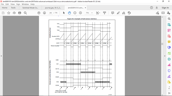

I am presently trying to implement the waveform "(a) PWM-ON" shown in figure below

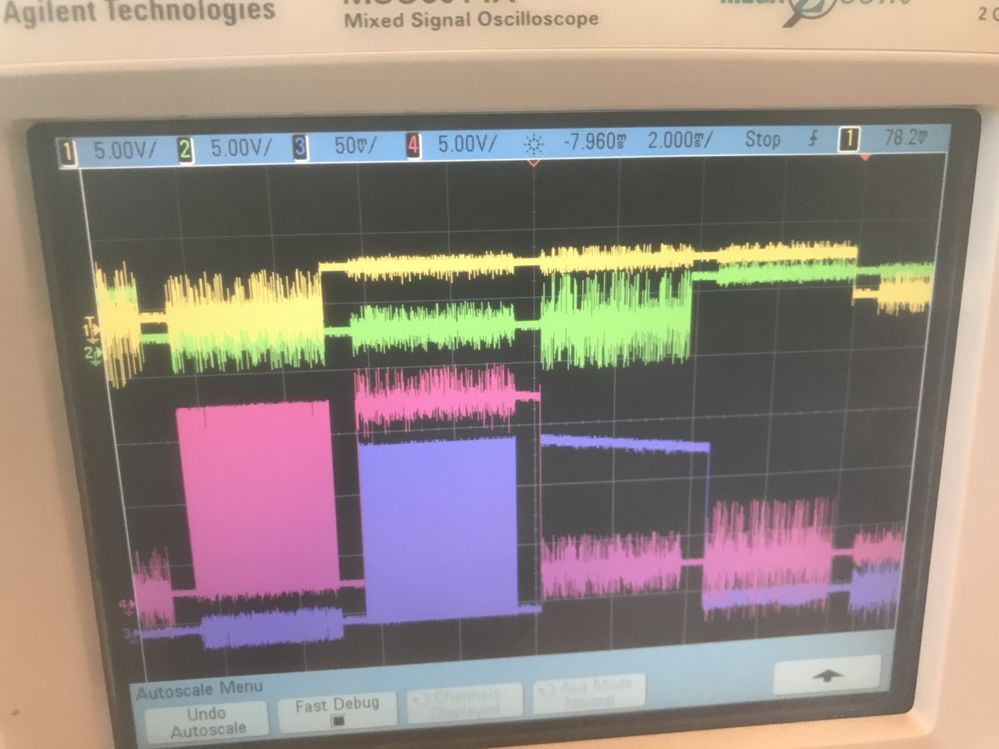

This is the result that I am getting on the output timers that generates output PWM signals.
-->The yellow and green waveforms are the hall sensor input signals. All the three hall sensors signals have been XORed internally in my MCU into a single channel TI1.
-->The blue waveform is the gate signal to the high side of the first leg.
-->The pink waveform is the gate signal to the low side of the second leg.
A zoom in:
Also here is an interesting picture showing the current waveform in pink color. The current decays to 0 between each step due to this delay problem

- There is this delay between the signals on each gate signal waveform (blue and purple). It sort of makes sense since, I use the hall sensor signal edges (rising and falling) to indicate a step (1-6). so at each step, another pulse is produced on the same hall sensor interface timer to use in triggering the configuration changes in the output PWM timer for my gate drivers.
- Hence it makes sense that there would be an initial delay, but after that there should be no delay as explained here in the manual RM0360
So how can I fix this delay?
I kinda think it could be a setting problem on the PWM timer - advanced timer 1. Maybe there is a setting to ensure the signals repeat and not get cleared until the next step.?

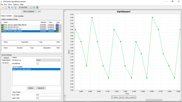

About outputting the corresponding commutation steps through the DAC. I might be inexperienced but I don't have a way to do that since the board - EVSPIN32F0251S1 - does not have an actual DAC. It only came with an external PWM DAC to transform the current reference - which is a PWM signal - into a DC value by passing it through a low-pass filter for a Peak current control.

@BoboyeOkeya​ whatever suits you, but yes to be able to vsualize your commutation steps along with your pwm gate driving signals will improve your debugging
‎2021-04-28 2:17 AM
@Javier Muñoz​ I kinda plotted the steps on software but you are right, it does not have the step like shape, however it does slopes down from 6 to 1 and vice versa, but sometimes it doesnt reach 6 or 1.
‎2021-04-28 2:23 AM
Depends of how fast are your steps going....
The SWV debugger will try to fish your variables from memory "at runtime"
But if your commutation steps are going much faster you will get undersampled signals like thisone you showed me in green.
what about slowing down (speeding down) the motor?

ohhhh yes thats true, its the signal acquisition. At slow speeds it tries to get the step form but it still doesnt.
During the process of the debuggings ive done earlier though, I was comparing the hall sensor signals to the PWM gate signals.
Here is my rookie deduction from the image I attached below in figure 1:
- At each rising/falling edge of the hall sensor signal, the gate signals fall to zero and hence the delay.
- The only reasonable deduction for this is that either the CCR values get cleared or the PWM timer is disabled
Figure 1
Hallsensor signals: yellow and green waveform
PWM Gate signals: pink and purple.
Figure 2: shows an example of how the hall sensor capture timers is interlinked with them PWM timer
