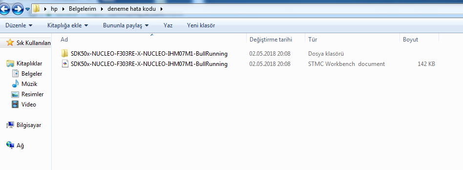

after you click/select on the [Generation] button of MCWorkbench, within the same folder where you saved the project (`<project name>.stmcx`), there should be a folder with the same exact name of the saved project. Within that folder there should be a .log file `<project name>.log`.
Can you share that log file with us?
It will help us to better understand this issue.
Best Regards.
Posted on May 02, 2018 at 19:16

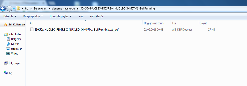

Hello dear
PALANO.Carmelo_Marce
I am so happy to see your reply.
There is no such a file unfortunately.
What I have can be seen in the screenshots I will just share.

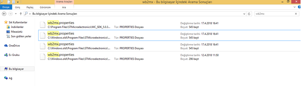

Hello
I searched many variation of ''/.st_motor_control/wb2mx.log'' such as wb2mx.log, wb2mx, st_motor_control/wb2mx.log and etc. However, nothing can be found except the 4 files in the Picture. I searched on my computer folder and STMicroelectronics folder. Thanks many times.....
