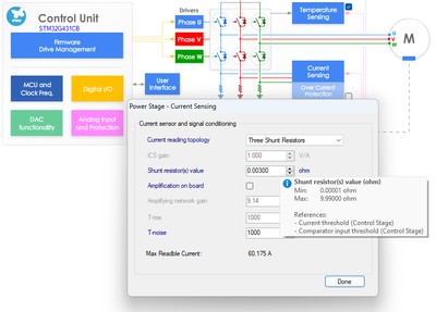

Hello @sb_st,
The X-NUCLEO-IHM17M1 power board provides OpAmp to interface with MCUs that do not have internal OpAmp IPs.
For the amplification path design, use the MCSDK 5.4.8 tool (available here). Load the "B-G431B-ESC1 electronic speed control" example. Click on the Current Sensing box and change the Rshunt value according to your requirements.
Click in the Analog Input and Protection box, in Sensing OPAMP part, click on Calculate to display the Amplifying Network Gain Calculator graphical tool.
If you agree with the answer, please accept it by clicking on 'Accept as solution'.
Best regards.

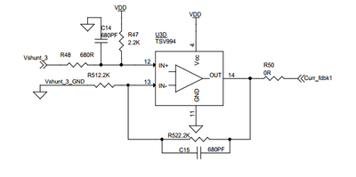

Maybe you could help me answer this question about the X-NUCLEO-IHM17M1: is this design for bidirectional or unipolar current measuring? It's not clear to me that a bias/offset voltage is being applied anywhere, so I *think* this board is intended to only read the shunts when a positive voltage is formed across them...is that right?
When i verified the schematic, the below section is used for current sensing
The equation i get is
Vout = 0.9 Vshunt + 0.9 V
So the offset is around 0.9V when 0 amps is flowing, anything below 0.9 will be negative current. So positive current will be upto 0.9 + 0.9 = 1.8V
Maximum Ishunt current you can measure is
if we put Rshunt = 0.1 Ohm
Ishunt = Vout/(0.9 * 0.1) = Vout /0.09
Vout max will be 0.9V
Ishunt max will be 10 amps.
This is my analysis please reverify from your end.
