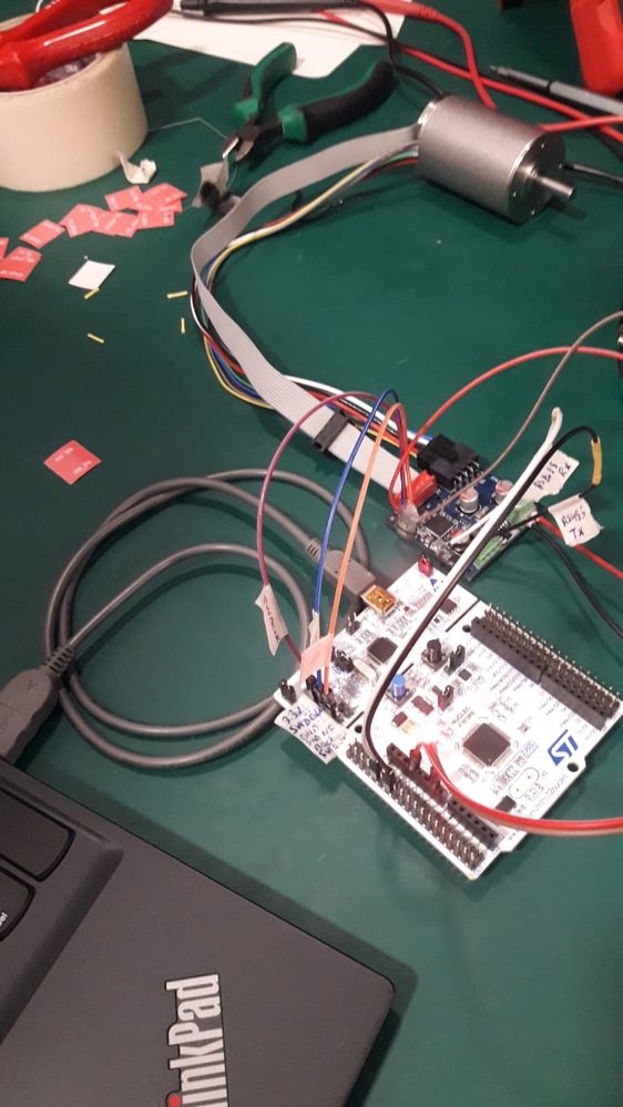

Hello everyone, I've a STM32F303RE & EVALKIT-ROBOT-1 kit. But ı dont control this system.How do ı connect this Stm32F303RE and EVALKIT using MODBUS protocole?
I tried connection using motor control software but i couldn't.

Hello @Rasit​ and welcome to the ST Community.
The EVALKIT-ROBOT-1 use a MODBUS communication protocol through RS-485​.
The MODBUS protocol is not the same of Motor Control Workbench.
You can find more details on communication protocol in the user manual UM2653
and other useful info in a previous thread
