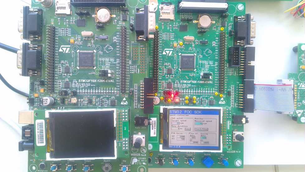

hi,
I got the STM3210B-MCKIT and use the 3.2 FOC Lib + Workbench 2.0.
I tried to get the Encoder control to work:
- I jused the SDK32x-STM3210B-EVAL-MB459-Shinano.stmc
- under Drive Management I changed the sensor selection to quadratur encoder
- exported the settings to System & Drive Params
- I compiled with IAR batch command
my problem is that the motor dont start correctly, i often got a overcurrent fault.
if its start it immediately stops.
if i rotate the motor by hand, the measured speed seems to be correct..
what do i wrong? the hall sensor doesnt work also. the sensorless control work as expected.
thanks

Hello Alexander,
do you have aligned the Encoder before to start the motor? You have to do this just one time pusking the button in the LCD.
Are you sure that you have properly connected the motor sensors?
Just to be sure I write you the correct configuration:
for the Encoder you have to conect the 4 wires connector Black-Red-Yellow-Blue in the J8 (respectively GND, 5V, none, H2, H1)
for the Hall sensors you have to connect the 5 wire connector Blu-Beige-Yellow-Green-Pink in the J8 (respectively GND, 5V, H3, H2, H1)
for both case the motor phases must be connected in J5 with this order: Red (pin 1), Black (pin 2), White (pin 3)
Ciao
Gigi

Hi Gigi,
it works now.
I first used my older MB525 REV B Eval Board with the MCKit and got the described problems.
With the the MB525 REV B which is delivered with the MCKit it works.
Same firmware and same connections.
Something has changed with boards although the Rev is the same - the left one is the older board that doesnt work with encoder. Perhaps a known error.
