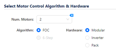

I have an application that requires 3 BLDC motors and I was wondering if I could use a single STM32 micro to run all three motors using the MC software library to interface to the hardware drivers of each motor.

According to my understanding the MCSDK can support maximum of 2 motors.
