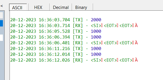

can you please check if my code is correct i cannot see the rpm that i am passing through uart receive dma is been set to motor
could anyone please correct me

void HAL_UART_RxCpltCallback(UART_HandleTypeDef *huart)
    HAL_UART_Transmit(&huart2, rxbuffer, 1, 100);
    HAL_UART_Receive_DMA(&huart2, rxbuffer, 1);
setMotorSpeed(atoi(rxbuffer));
Your setMotorSpeed to be done after receiving the data.
The startMotor function is sufficient to call once.
Got single byte receive. Not able to receive a string.
You call a blocking function in the callback
One case you try to pass a variable when it wants a pointer.
HAL_UART_Transmit(&huart2, (uint8_t*)rxbuffer, 4, 100);
        HAL_UART_Receive_DMA(&huart2, (uint8_t*)rxbuffer, 4);
if (strncmp((const char*)rxbuffer, "start", sizeof("start") - 1) == 0)
flag = 1;
//MC_StartMotor1();
else if (strncmp((const char*)rxbuffer, "stop", sizeof("stop") - 1) == 0)
flag = 0;
//MC_StopMotor1();
else
rxbuffer[4] = '\0';
uint16_t rpmValue = atoi((char*)rxbuffer);
if (500 <= rpmValue && rpmValue <= 3000)
setMotorSpeed(rpmValue);
else
HAL_UART_Transmit(&huart2, (uint8_t*)"Invalid command or RPM value\r\n", 30, 100);
i have changed my code can you please refer it again and tell me modifications @Tesla DeLorean @SRedd.5
