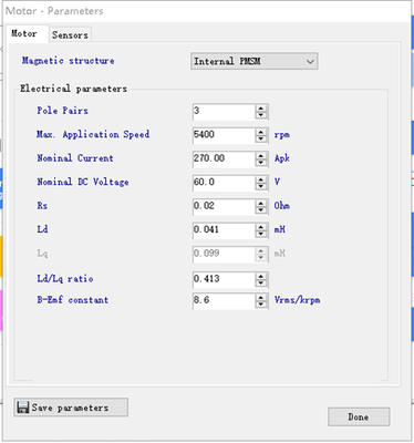

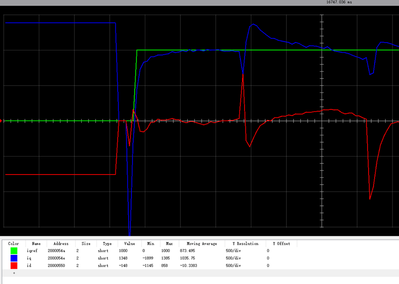

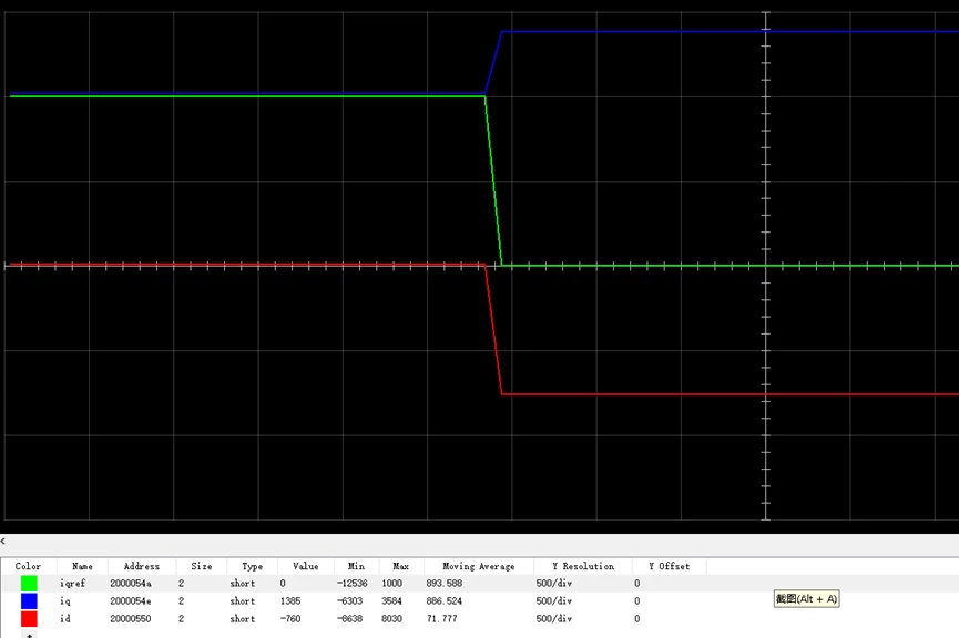

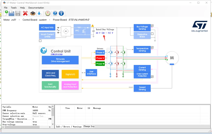

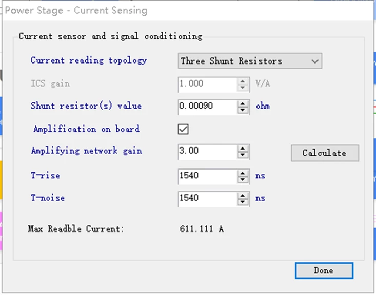

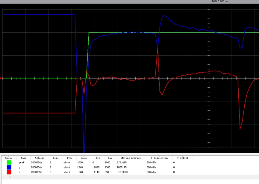

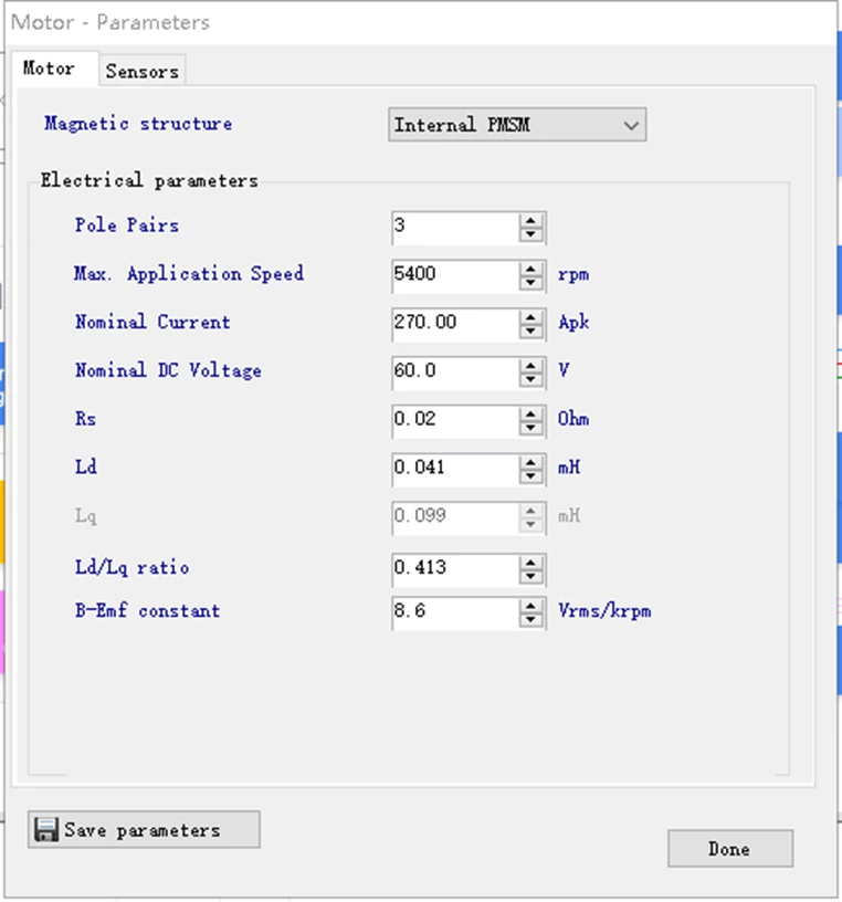

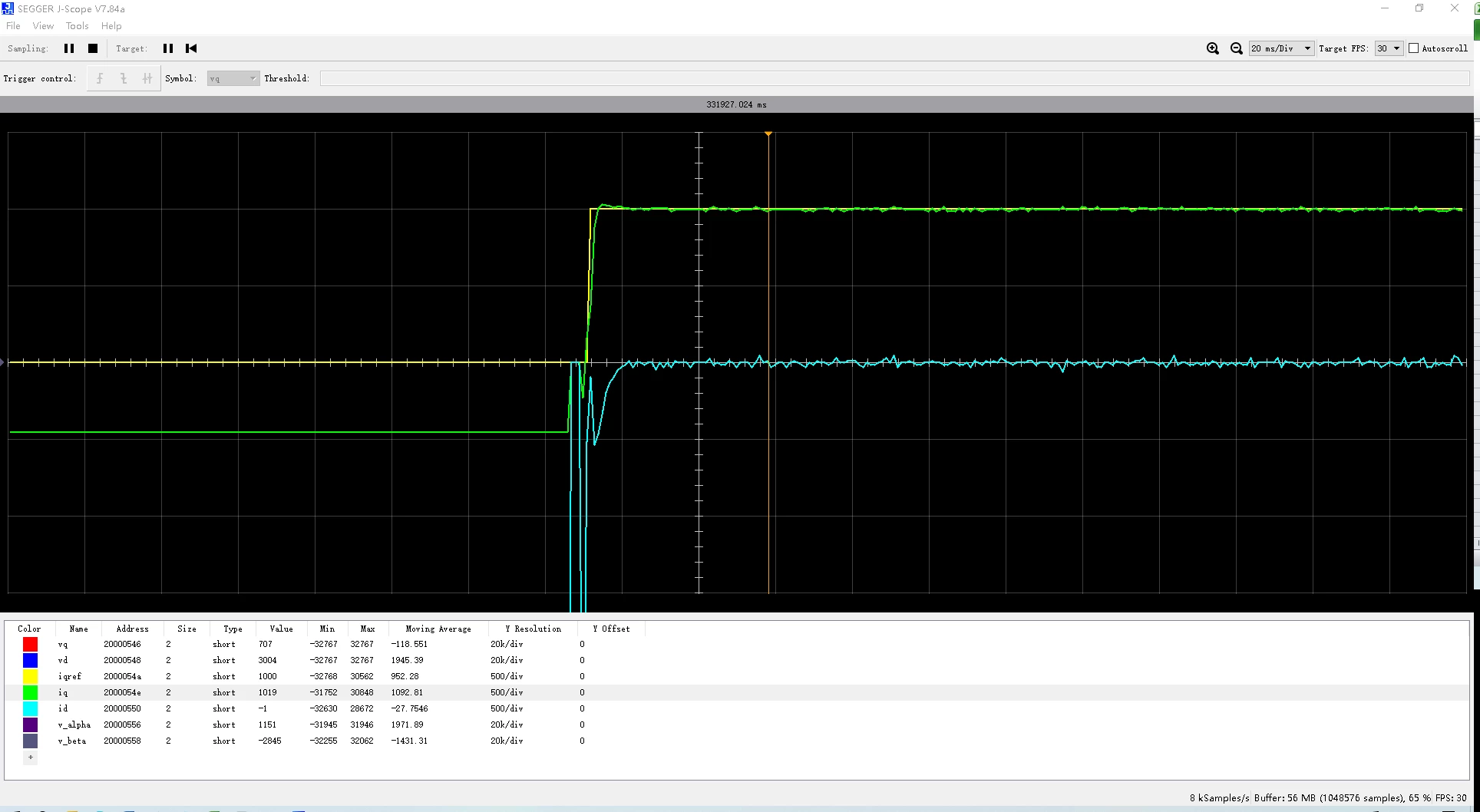

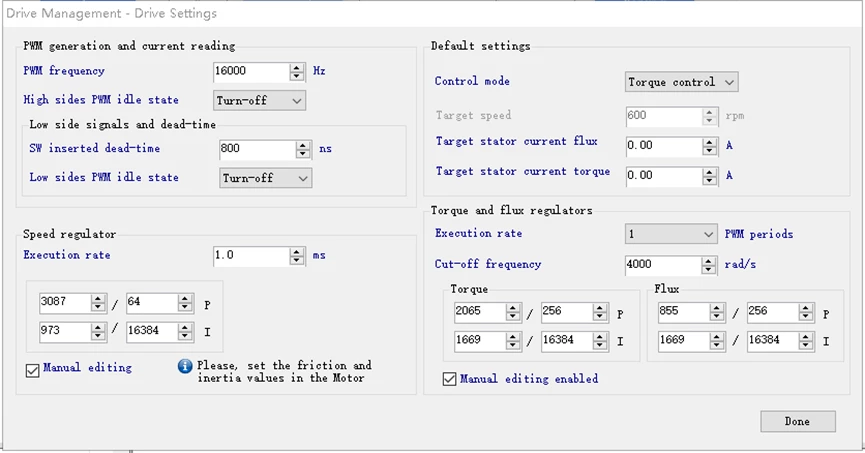

sunboy_351_1-1703141714429.pngMCSDK5.4.8版本 相最大电流270A,采样电阻0.0009欧,Lq 0.0991mH,Ld 0.04115mH,定子电阻0.01974毫欧,三电阻采样,相电流采样放大倍数3,电机相移角295度,PWM  16000Hz, 扭矩环调参后电机轴抱死,无法启动。

    Have you tried reducing the gains? Have you tried X-CUBE-MCSDK-6?

    BMS128-60H  Motor(Hall)
    示例
    参数值
    示例
    参数值
    voltage platform
    60V/72VDC
    rated power
    1.5kW
    peak power
    4KW
    rated torque
    4.1N.m
    Peak torque
    45N.m
    peak current
    270A(45Nm)
    Max.speed
    5400rpm
    Ke
    8.63V/krpm(线反电动势有效值)
    POLE_PAIR_NUM
    3
    Lq
    0.09991mH
    ld
    0.04115mH
    Rs(line)
    19.74mΩ
    Max.fwcurrent
    212ARMS
    温度传感器型号
    MF58-503F3950
    Max.power
    4kW
    Max.torque
    45Nm
    rotational inertia
    2.6g.m2
    Motor parameter

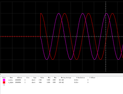

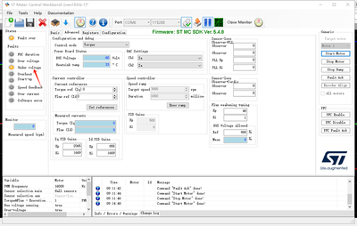

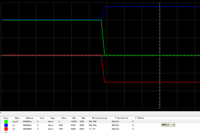

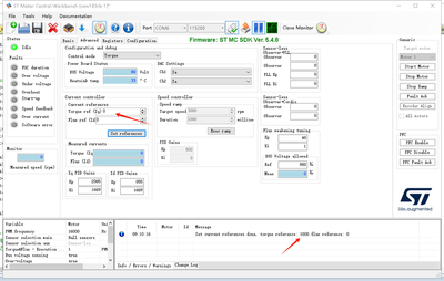

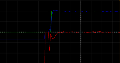

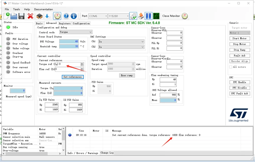

    Workbench:
    test

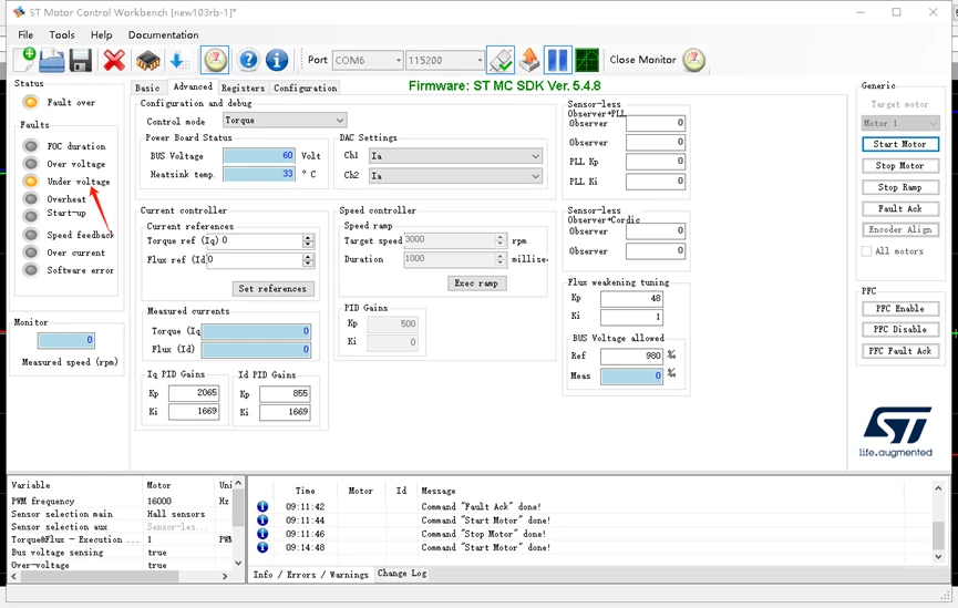

    1 first start  status  under voltage
    2.clear  the  fault  next  start

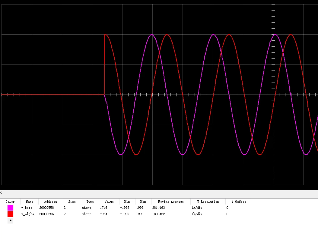

    motor Vibration  status  Run  is not faults
    Stop-> next start:  motor is not rotate
    Open loop   motor Normal rotation
    I use STM32F103RBT6, 64MHz, the above problem occurs, how to find the problem point?
