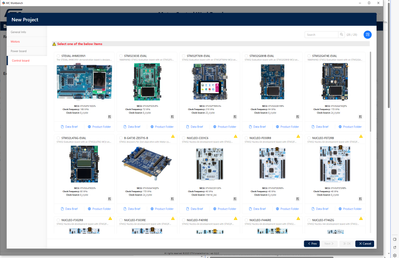

If you launch the MC Workbench, you will be able to select it and see the Control Boards compatible with it, if you choose a Nucleo, you need a Bridge card such as the X-NUCLEO-IHM09M2.

The only Board that can match your specifications is the STEVAL-CTM009V1 and which is supported on MCSDK 6.2.
because very few cards currently support 90Adc.
