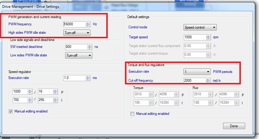

@Fkadr.1 (Community Member)
1) Means these 10 parameters (as attached) is sufficient to spin the motor ? Rest should be default in mcsdk 5.4.6 ?
2) How to choose PWM Frequency and Execution Rate ? According to Motor Parameter ?
Any other suggestions ...
