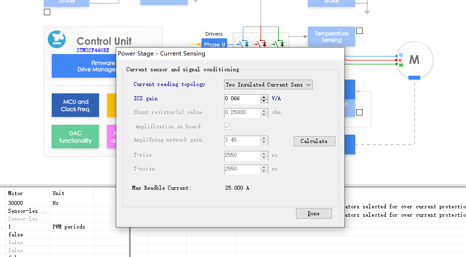

My hardware:
NUCLEO-F446RE + TI DRV8353 demo board(6 x PWM) + ACS725-20AB

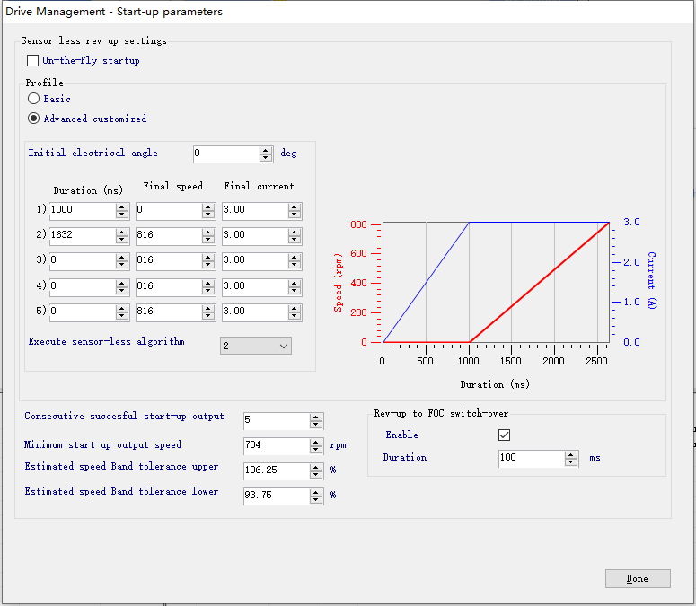

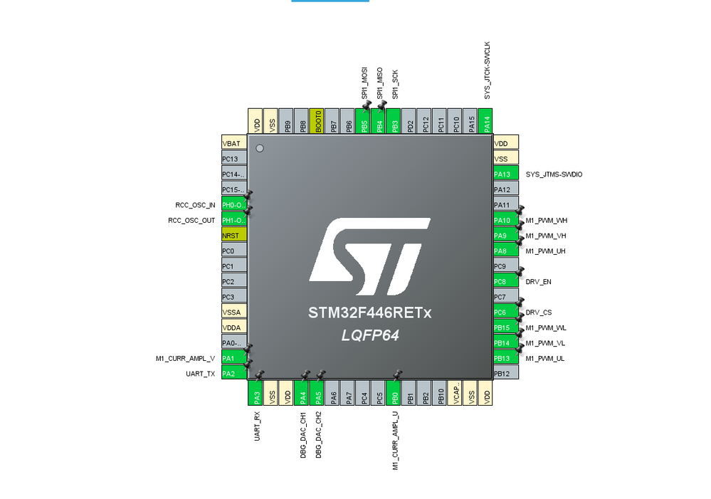

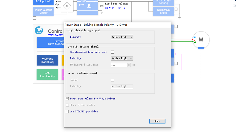

1.I set the Low side driving signal is Active high.0693W00000LyhLQQAZ.png​2.Set current sensor and ICS gain0693W00000LyhLuQAJ.png3.Start-up0693W00000LyhKTQAZ.png4.Use cubeMX add drv8353 enable pin and spi pin

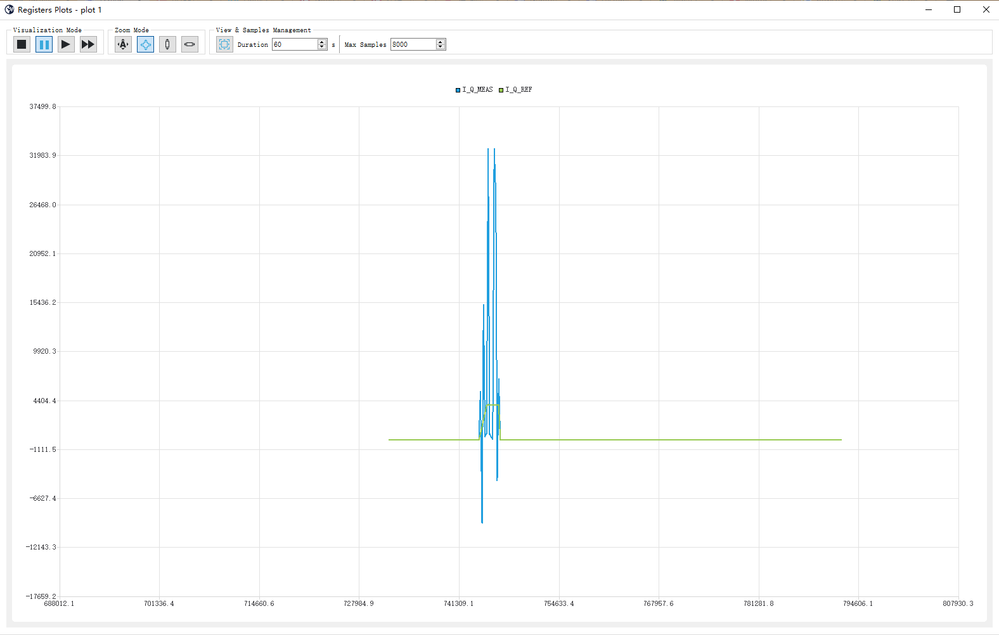

0693W00000LyhMnQAJ.pngBut the motor start error.(It work well in NUCELO-F446RE+IHM08M1)

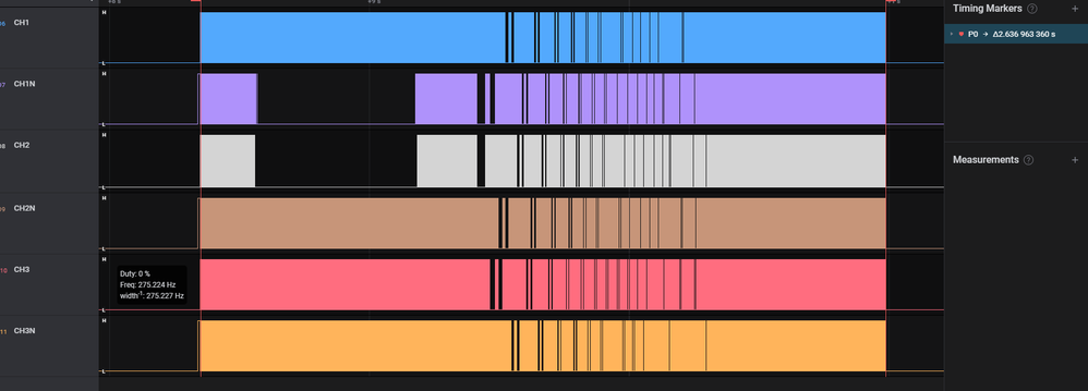

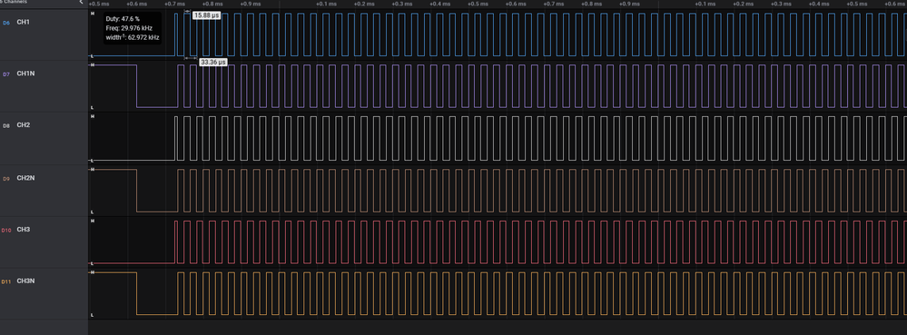

0693W00000LyhMtQAJ.pngPWM output
If the pwmout 's problem or the current sensor?​
