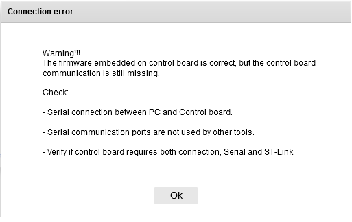

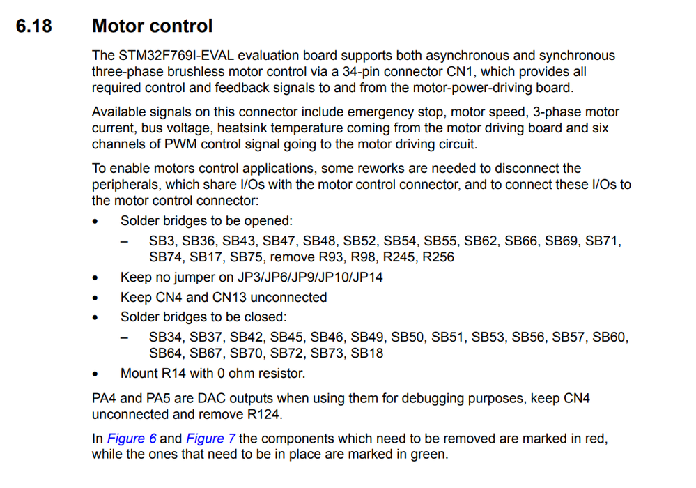

I have a stm32f769i-eval board and steval028v2. I look the UM2035 and did some modification on stm32f769i. After than i connected the boards each other and pc.I start the motor profiler but didnt work. I get a error. I connect on STlink port to pc usb port. My st link driver updated. Could you help me ?
sorry for my poor eng.
ERROR
EDİT////////////////////////////
i solved, be sure connect your rs232 and st link
