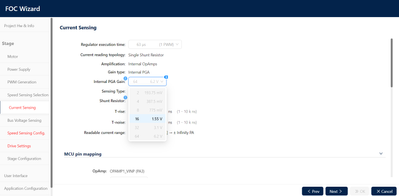

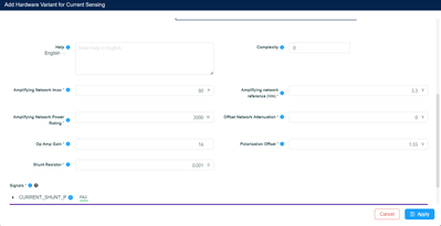

I am using MCSDK 6.4.1 to create my custom inverter board. I have configured the internal Op-amp's PGA gain.
However, when I load the configuration into the MCSDK project, it is not detected, and I am unable to select a gain of 16.
MCSDK doesn't recognize my board config, and it doesn't calculate the current range.
If it's not MCSDK that's wrong, please help me fix my wrong config

I assume you have to provide the offset network attenuation sample from ST board as below

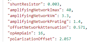

Hello @VPTEK,
Can you share your json custom board file?
