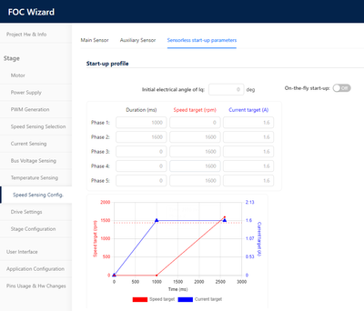

If with load, the motor is not able to spin, it could mean that your selected board does not provide enough power at the beginning. Does Sensor Less RevUp table uses the maximum allowed current?
You can also dynamically tune the current target parameter through the Motor Pilot tool in the Rev-up tab.

as I said, I already tried your suggested adjustments in the rev up table until I got overcurrent events.

I was playing around with the rev up parameters until I managed to get the motor spinning with the load in sensor less mode.

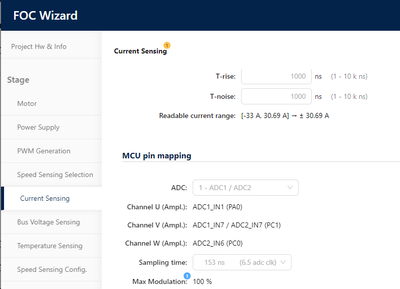

How ever the max. speed is limited to about 30% of the max application speed the motor is rated for (3k RPM). Even I give  a higher set value there is the ceiling at ca. 1150 RPM. The power draw in this state is about 15W@12V and far away from the current limit of 4A. What is limiting the speed?
GMA
Hello @BWI,
The maximum speed might be limited by the Max Modulation index value if it is not computed close to 100%.
If applicable, you can improve it by reducing the PWM frequency.
If you agree with the answer, please accept it by clicking on 'Accept as solution'.
