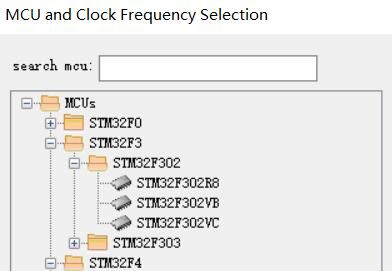

I have designed an FOC driving board using the chip STM32F302K6U6,but I can't find the the chip in the latest version of MCSDK.
0693W00000GY8pdQAD.jpgHow can I create an FOC project by the chip?

I just created an STM32F302R8 project by MCSDK,and imitated the configuration and the code.Honestly speaking,I've learned a lot in the process of reading the code step by step.
