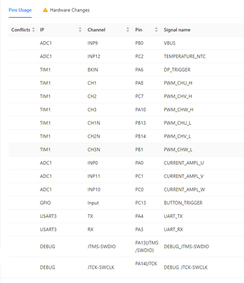

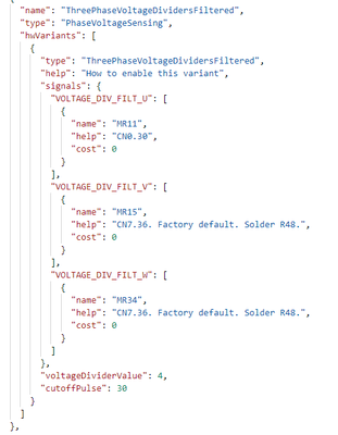

I am designing FOC motor controller based on DRV8316. For this, I am adding a DRV8316 custom board in the MC Workbench. Please find the JSON file attached.
The problem is that I am unable to add phase voltage sensing. Although I have added phase voltage sensing in the JSON file it is not appearing in MC Workbench.
Thanks

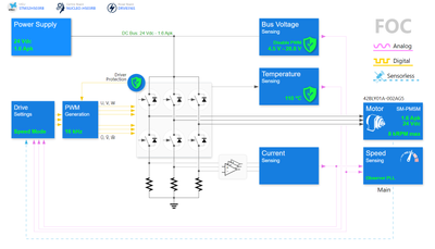

2024-08-28 12:40 AM
Thanks for the recommendation. I have tried MCSDK V6.3, yes it is easy to implemet custom board in it. But phase voltage sensing is also not working in MCSDK V6.3.
