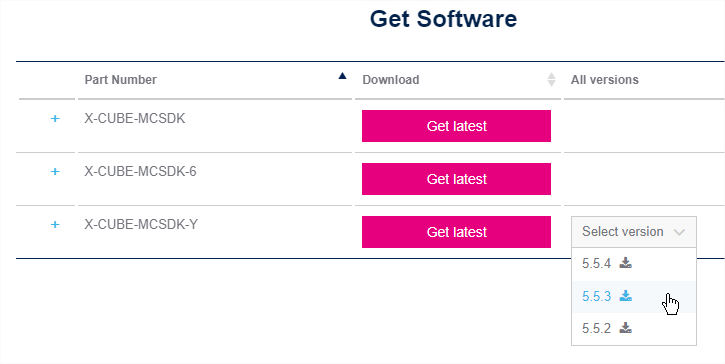

IS there a FUL version of MotorControl 5.Y.3 (X-CUBE-MCSDK-FUL_5.Y.3)?
DSchu.9
After working with FUL_5.Y.2, I need some of the features offered in 5.Y.3.
I believe I clicked on the 5.5.3 version when downloading. Is 5.5.3 actually 5.Y.2? Or did I misclick? I did have trouble downloading, as my browser crashed and sent ~12 requests .

Using following link
X-CUBE-MCSDK - STM32 Motor Control Software Development Kit (MCSDK) - STMicroelectronics
You are right, the version is visible as "5.5.3".
0693W00000QLPn4QAH.pngAfter passed the "Agreement" and "Get Software" process, I was able to download "en.X-CUBE-MCSDK_5.Y.3.zip" file.

This is unfortunately not the -FUL version of the file.
GMA
The 5.Y.4 is FUL version by default, could you this one?

Unfortunately the 5.Y.4 version has issues when generating pwm_curr_fdbk.c and related files, while the 5.Y.3 version does not.

What kind of errors do you have?
May be that upgrading CubeMx to 6.5 and STM32 FW to V1.5 could help...
Pointer is null or missing on generation of pwm_curr_fdbk.c. I've tried every single combination of firmwares and CubeMXs (include both recommended and most recent) and none work. It's a problem another employee explained earlier that was apparently in the works of being fixed.
However, my problem has been solved by reverting to 5.Y.2.
