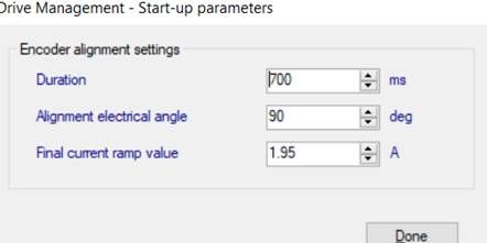

I have the ST FOC motor control kit (Nucleo F302R8 , X-Nucleo- IMH07M1. I have been successful using FOC with sensorless feedback. I have installed and wired an absolute encoder and configured the number of pulses in the workbench. What I cannot find are instructions for aligning the encoder. I see the GUI in the motor control workbench has a button for "align encoder" but it is not clear to me how the offset is properly set. I have clicked align (small movement) and then start motor but I get no rotation, just high current draw and a locked rotor.

1.Am I correct to assume the only thing that is needed to align the encoder to 90degrees is to set this alignment value in motor control work bench, build the project and then from the monitor click "align encoder" (shaft moves) then "start motor" and the motor should spin? Right now it just locks up.
2.Since the motor is not spinning but locked and drawing current I have tried reversing the counts (from workbench) and re-building, also tried different sequence wiring on the motor. The rotor is still locked, do you have any suggested next steps? This would be greatly appreciated. Thank you! Dan

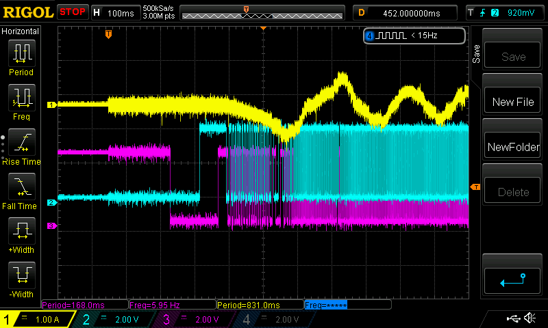

THis may help you:
- confirm encoder noise, if there is big noise, add capacitor or change pull up resistor
- set up the start up, and confirm A+, B+ Phase, if it does not work you may exchange A+ and B+ and try

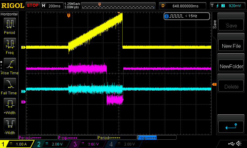

- a correct align is only one pulse, I attach the waveform Yellow is U phase current, Pink is A+, blue is B+
Start up waveform
align waveform
