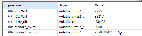

I use a STM32F103 chip and I try to synchronize two DC motors using inputcapture, I read the time difference between the rising edge of each sensor hall of effect,how can I update the pwm of the two motors. please check with me the pg

kkhli.1
i used TIM1 to capture the  the rising edge of the input signal on channel 1 for the sensor 1 and the channel 4 to capture the  the rising edge of the input signal sensor2 , with live expression i can read the two sensors value0693W00000aJlHHQA0.png

The synchronization logic implemented here in you code assumes that the two DC motors are mechanically coupled in such a way that they should rotate at the same speed.. are they?
to ensure that the PWM updates are applied, the motor control loop should run at a higher frequency than the input capture interrupts.. So, you may want to consider implementing a separate motor control loop that runs at a higher frequency
Hope that helps!
kkhli.1
yes exactly they should rotate at the same speed.. this is the configuration of the TIM1 used for incapture interrupts :(the clock frequency is 72 MHZ)
