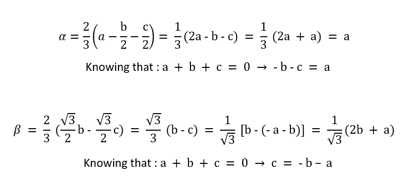

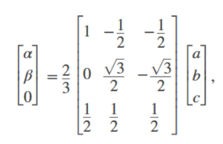

Developing my point, we start with :
0693W00000aHioFQAS.pngwhich gives :
0693W00000aHj0JQAS.pngWe find the values given in MCM_Clarke function.
