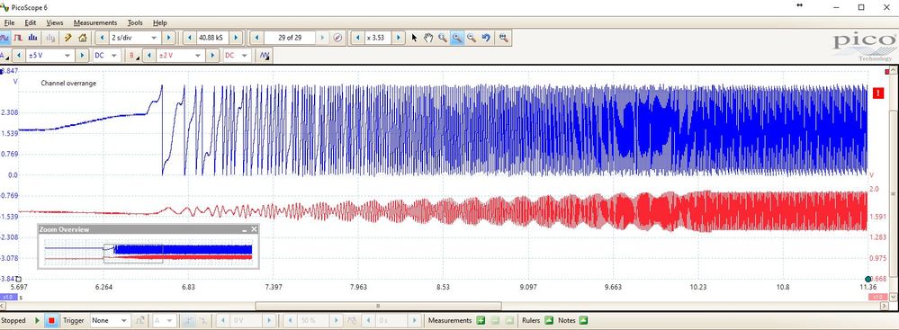

How to tune sensorless start-up of low inertia motor
  • November 6, 2021
  • 1 reply
  • 1356 views

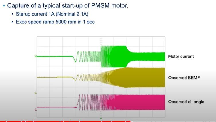

I am using an STM32G431 running the ST motor control library for FOC sensorless control. My motor is running but the start-up performance is not satisfactory. I have about a 10% start failure. I have watched the YouTube video: Motor Control Part5 - 7 FOC with STM32 (STO, PLL, Cordic, MTPA, FW, FF) and they show a plot of Observer Elec Angle and Observer BEMF as shown here: Note the bemf amplitude is very clean and uniform, no modulation.
0693W00000GWgThQAL.jpgFor my motor I think the low inertia could be a problem. The start current is about 500mA but the run current is only about 35mA. My similar profile of Observer Elec Angle and BEMF is shown here:
0693W00000GWgUGQA1.jpgNote the ramp-up BEMF is modulated quite a bit. I think this leads to the high failure rate. I get MC_START_UP failures. I've tried tuning everything I can think of but can't find a good solution yet.
Can anyone give me some guidance on this?
Thanks,
Brian
