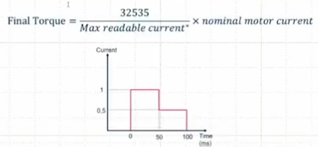

  5. What I have found is that I thought that my motor is 2.5A, and 1.2A (around 50%) in 5-steps start-up parameters was giving me around 2000 torque in Monitor's Configuration tab. This number you can calculate according to the formula (pic below).
  6. I had to lower the torque value from ~2000 down to ~400, which gave me about 0.25A in start-up parameters, I had massive speed overshoots in startup procedure
