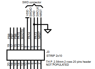

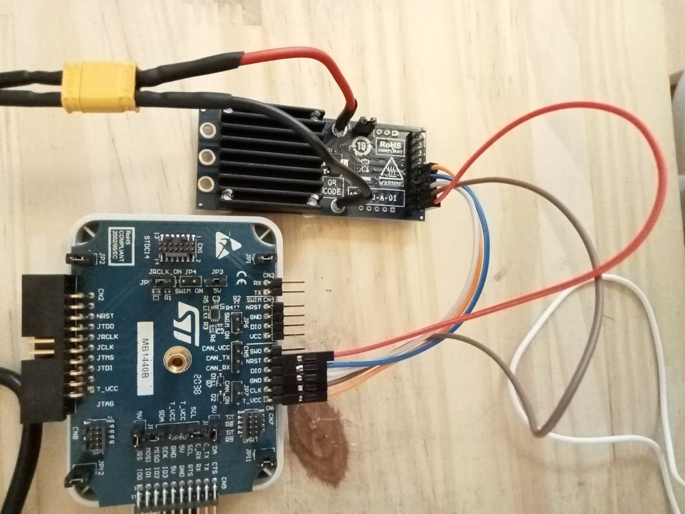

The board is a STEVAL-PTOOL1V1. The setup was tried on different boards.
The programmer board used is a STLINK-V3SET.
I followed the instructions on the `Getting started` document of the STEVAL-PTOOL1V1.
I power the board through J1 and J2 with a power supply supplying 12V.
I connected J8 with a jumper.
I connected the SWD pins to the STLINKS.
Here is the setup and the documentation for the SWD connector of the PTOOL1V1.

In STM32CubeProgrammer, I tried changing the configuration of the STLINK. The port is at `SWD`. I tried `Hardware`, `Core` and `Software` for the reset mode. I tried `Normal`, `Under Reset` and `Hot plug` for the mode. Same result with every configurations.
When the board is powered, I have a tension of 3.3V on the VDD of the SWD connector.
Any idea why the flashing process is not working ?

‎2021-10-19 7:12 AM
Hi @TLe M.1​ ,
I think the problem is a typo in the documentation. Data and clock lines of the SWD are swapped.
Could you please check if swapping the two lines solves the issue?
Hope this helps you! I'll be waiting for your feedback.

‎2021-10-19 7:12 AM
Hi @TLe M.1​ ,
When your question is answered, please close this topic by choosing Select as Best. This will help other users find that answer faster.
Imen
Thanks
Imen
‎2021-10-19 10:14 AM
I think that your issue has been solved with my proposal update.
Glad to know this :)
An update of all the related docs is planned to correct the typo.
Thanks for your contribution, and don't hesitate to come back to the Community if you have any issue/feedback.
