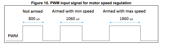

You will be able to activate the ESC on the workbench and control the speed of your motor with a PWM input.
The electronic speed control (ESC) feature allows to control the motor speed with a PWM signal in input, for example on the B-G431B-ESC1 boards it is possible to use this feature to control the motors of a drone sending a PWM signal with a different duty cycle to switch the motor to armed, armed with a minimum speed, armed with a maximum speed and unarmed state.

To control the motor, you must first put it in unarmed state and then increase the duty cycle.
You can use a debugger and follow pHandle->sm_state variable that indicate the state of your ESC.
The state should begin to ESC_ARMING then ESC_ARMED and finally ESC_POSITIVE_RUN.
You can find more information in the file esc.c
