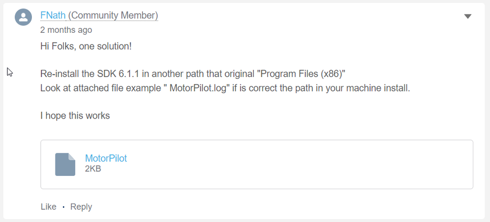

Wow, thanks for taking time to post this even after you found a solution. To be clear, I just installed it in C:/ST/something and it worked out of the box. Probably something about space in the path.
