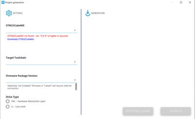

i installed x-cube sdk  then  i wanted to make project for an example but even tough i installed last version of cube mx program but i am taked that things all the time thanks for your help.

Hello @erenyurdagul,
Could you have a look to this post?
When installing the STM32CubeMX tool, ensure that there are no special symbols (“Ç”, “Ş”, “Ğ”, “Ö”, “Ü”, ...) in the path.
