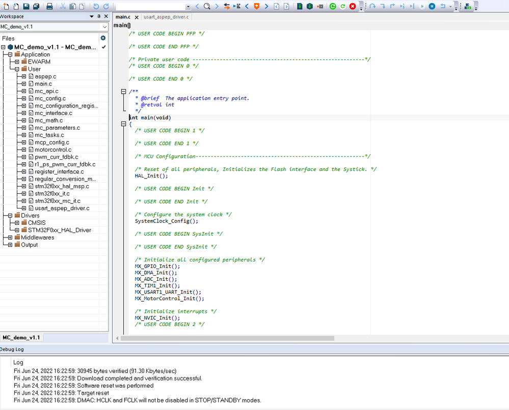

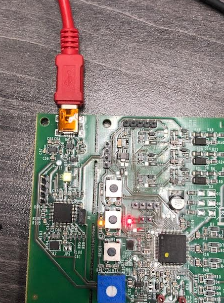

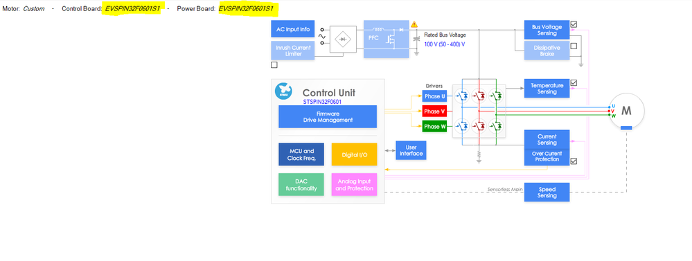

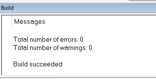

Hi, I'm new to the STMicroelectronics environment and I'm having issues with the EVSPIN32F0601S1 development board. I'm trying to spin a motor but I'm having issues connecting the evaluation board to the Motor Pilot GUI. I followed the video from the DevCon 2020 presentation video, but I'm getting a "Port open and try to configure the board" message from the Motor Pilot GUI.
My work flow goes as follows:
  1. Use Motor Control Workbench 5.Y.4 to configure the settings for EVSPIN32F0601S1 board.
  2. Generate .ioc file.
  3. Use IAR embedded workbench to convert the .ioc file to code.
  4. Rebuild code in IAR embedded workbench.
  5. Download and debug code to evaluation board.
  6. Try to connect Motor Pilot to evaluation board.
Here are some images, hopefully they help.
0693W00000NsjJ3QAJ.png0693W00000NsjIoQAJ.png0693W00000NsjItQAJ.png0693W00000NsjIyQAJ.png0693W00000NsjJ8QAJ.png
